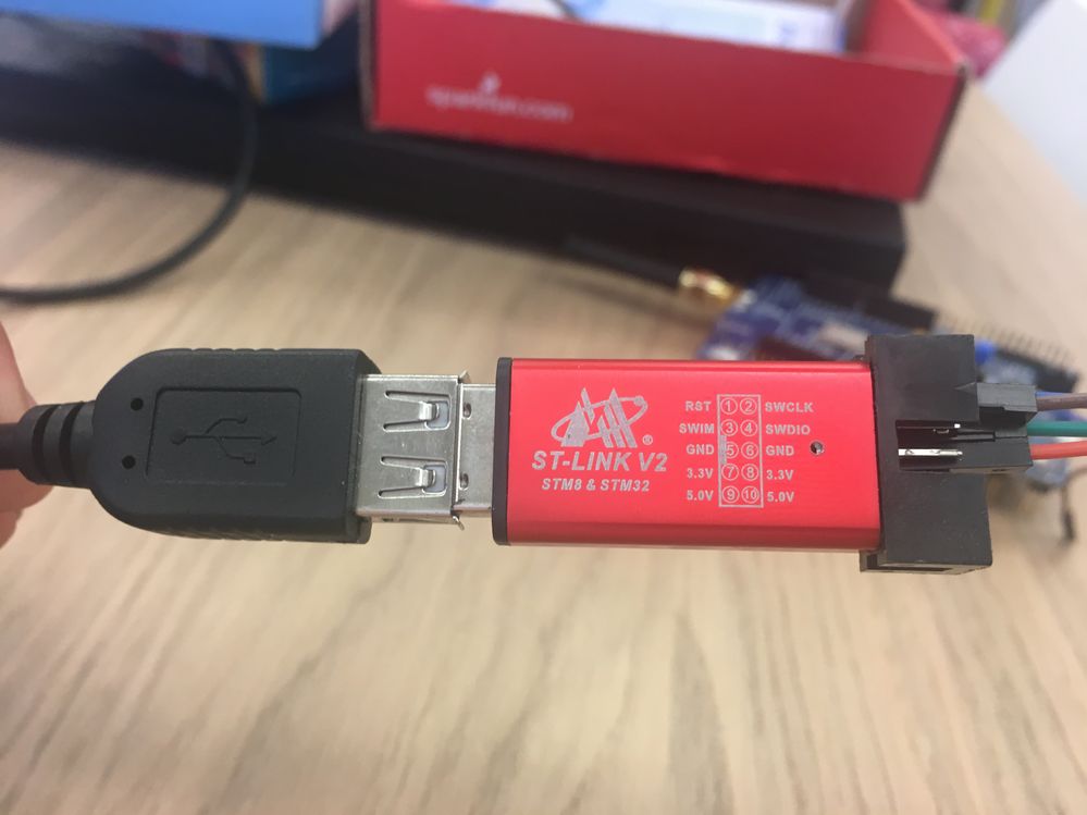

but how to connect, and how to flash ? :smirking_face:
and it look to have an micro usb connectot with the text "USB STLINK". May it be integrated?

The Discovery board has a built-in ST-LINK, so the external one is not required.
The mbed drive should accept a firmware binary in the form FW.BIN, in Windows a drag-n-drop operation, or COPY from the console.
It will not accept .HEX or .ELF files, so those would need to be converted with objcopy (as I recall)
