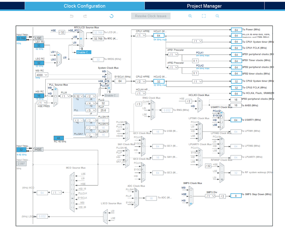

Hey everyone,
I'm using a stm32wb55 nucleo board.
When i'm using ST example about RTC, i have a problem with the accuracy of RTC and i want to know how i can configure RTC for increase her accurancy?
I.E.: all of 10 minutes i lose 6 seconds
Thanks in advance for any help.

Does it lose time in a step or continuous? Do you run with LSE or some other clock? Why don't you give more information? In general, check your code and quarz!
anoli
It lose time in continuous and i use this clock configuration:0690X0000088pLrQAI.png
Uwe Bonnes
Principal III
So check the quarz. Maybe it is 32 k and not 2^15. Or maybe the load capacitance is far off. Or it is broken...
