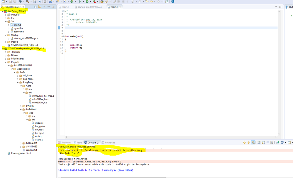

How to add ICUBE LRwan Lora pacakege into my project in stm32ide
shadab abedin
How to add LORAWAN package into my project and I try to include the package into include path but not any success.0693W000006FYi6QAG.png
4 REPLIES 4
I'm not a STM32CubeIDE user, but this project looks to have far too many files and subdirectories included in it.
I would recommend cloning the PingPong project, and using that as a starting point to include your own code and files

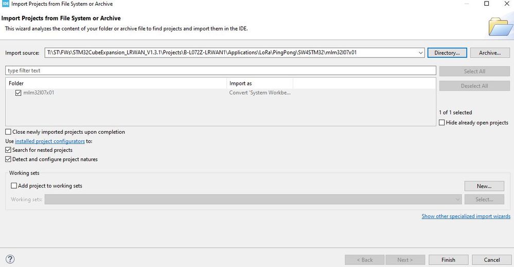

Cartu38 OpenDev
Lead III
File > Open Project From File System :
Not a user of this IDE or Eclipse based tools. Keil allows me to be at the PingPong project level/depth and then back reference relatively into the HAL libraries, middleware, etc.​
The alternative presumably would be to make a more self contained tree where just the libraries, etc are copied/forked​, along with the singular project files, and deal with the more truncated relative paths within that.
