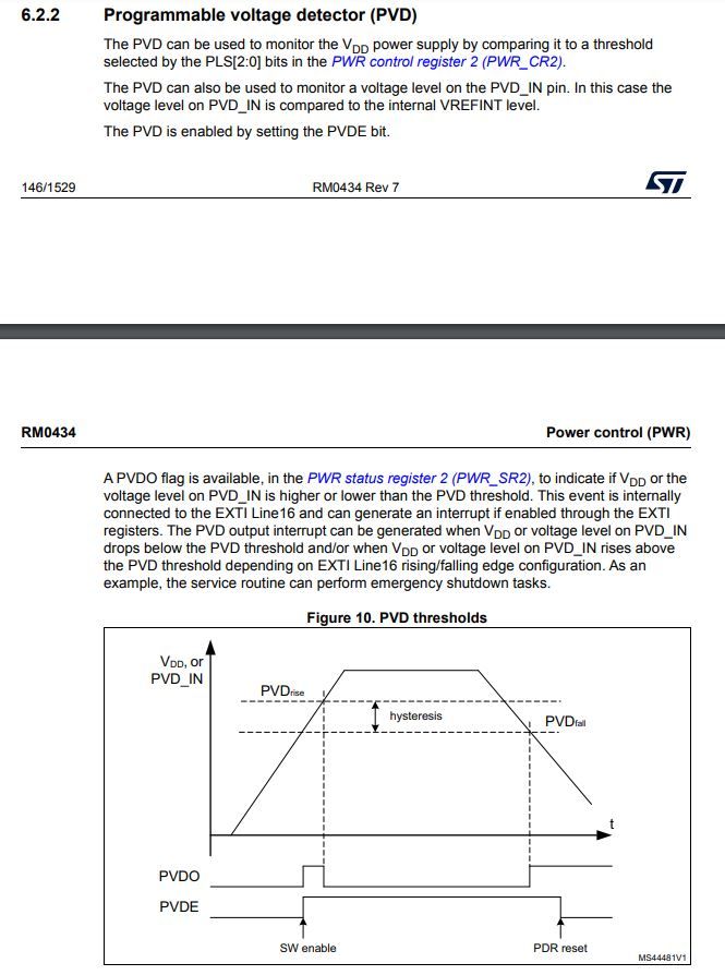

I am using the Nucleo WB55 Development Board, how do I set up the (Programmable voltage detector) PVD and get it to work?

I advise you to read RM0434 : 6.2.2 Programmable voltage detector (PVD) section.
