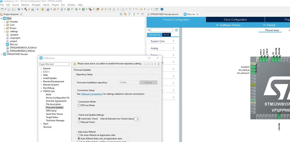

Could you share where is your firmware packs repository (Preference windows below snapshot like).
Could you have a try promoting another workspace repository. Sounds you're relying on default what's good but to help figuring out what's not ok if your local env may help to have an extra try.
Possibly share .*log* as part of your workspace .metadata folder ....
Based on your .ioc file I'm able to reproduce from time to time your issue .... (not systematic so) but if failing getting some weird trace within such log files ... such may help ST to dig into issue I guess

Looking at your log, nothing that help to catch the issue. But let's look for another way:
  • Reboot you PC
  • Open CubeIDE
  • Delete any opened project
  • Go to Help Windows > Preferences > STM32Cube > Firmware Updater
  • Browse new 'Firmware installation repository' (for example Downloads folder)
  • Click 'Apply and Close'
  • Open new WB project
  • FW download should be start
Hope this will work !
