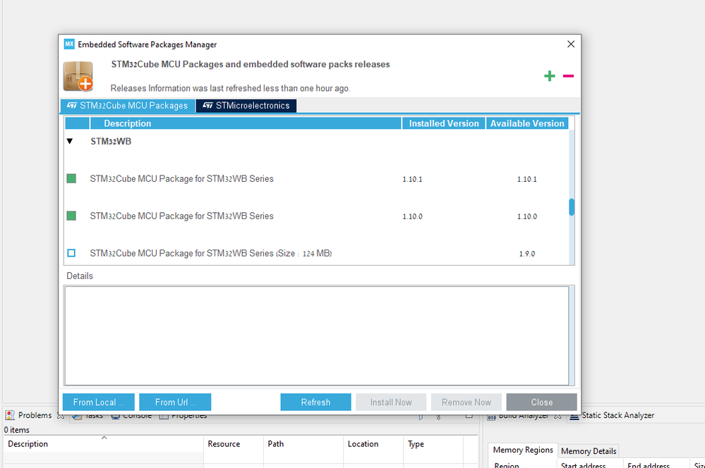

Let's first recapitulate the problem: so you're not able to generate because of the missing STM32Cube_FW_WB_V1.10.1 firmware in you repository and when trying to install this package, the download process is ending with the error "Target directory already exists" (same for STM32F4 firmware) . Please correct me if I misunderstood.
As indicated by the error message, a directory with the CubeFW name exists in the repository, please inspect the Repository folder, and delete the unexpected directory.
Backing to one of your screenshots:
0693W000008GC5HQAW.pngI can see here that STM32Cube_FW_WB_V1.10.1 firmware is correctly installed. Thus, normally the misbehavior is corrected.

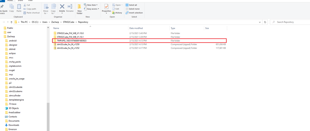

Otherwise, backing to the following screenshot:
0693W000008GCH3QAO.pngNormally the framed folder will disappear automatically after the end of the download process. Does this happens in your case or do you always see this file in your repository folder?
PS: Trying to delete the "TMPUPD_.... " folder above during firmware install corrupt the unzip process and in this case the "Target directory already exists" error may occur. In addition, trying to modify the content of this folder fails the install process.
