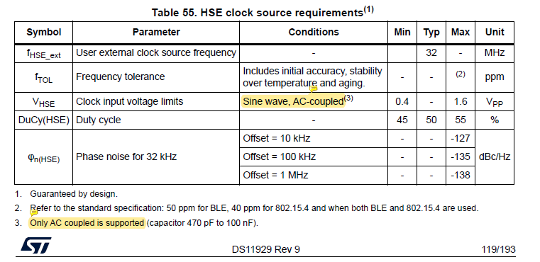

Another question: In the reference manual RM0434, it is specified, that an external clock has to have a sinus signal. I haven´t found many external clocks with a sinus. 99 % of them have a rectangle. If I use the MCO (master clock output) to output the clock of the external crystal, I also see a rectangle in the oscilloscope.
So, to sum up my questions:
  • Does the MCO show the exact waveform of the input signal? Or to be more precise, does the NX2016SA generate a sinus signal?
  • Is it true, that an external clock for the HSE would have to be a sinus signal? That would limit the available products to ~1 %.
  • Is it generally recommended to use an external clock instead of the oscillator or are the downsides so bad, that nobody does it?
  • I did not order an external clock yet and thus, could not test it. Is the typical specified startup time generally much less than the max. specified startup time? If it really is 1 ms for most external clocks, I see that as a total deal breaker.
no. see ds ->

520-2520MVLC-320CNTR  ; 32M, 1$ , 25ppm. drive at VCC about 1,6V , and cap + 75 r in series to cpu clk in.
Thanks for the information! Yes, a crystal does not generate a signal by itself but is used as a part of the oscillation circuit and driven by the microcontroller to generate an oscillating signal . Is this signal square wave or sinus?
Regarding the requirement for the HSE signal: I was using an older revision of the datasheet. Interesting how things change. 1,6 V (max.) Vpp means a signal from 0 V to 3,2 V (max.) should suffice, right? I would probably go for 3 V as voltage, because this is the voltage I use for the microcontroller.
Ok, then I will give an external clock oscillator a try. Do you have any data on the actual (not datasheet) startup time of the 520-2520MVLC-320CNTR?
Thanks!
no - is too much.  give 1,6V vcc to the oszillator, then it will output 1,6vss sqw. , thats according to ds.
 10nf + 75 ohm in series , so its AC coupled.
I am pretty sure Vpp should mean voltage peak to peak. If I run the microcontroller at 3 V (Vdd), I do not want to use an extra LDO or something just for the HSE.
-- so use some 3 diodes series forward , to get the voltage down for 1,6v at the osz.
and i am sure. at 3V the osz. will output 3Vss .

Would someone from ST please clarify, if 1,6 V Vpp means that the HSE oscillator input can be as high as 3,2 V or 1,6 V (DS11929)?

Interestingly, the WB series doesn't seem to support active oscillators. AFAIU it's because of the trimming which only works if the STM controls the complete feedback loop.
Anyway, concerning power consumption, from the MHz-oscillators that I know (even the MEMS-types, which are surprisingly good these days) I cannot imagine that you can save power with these, even if they have a faster start-up time.
