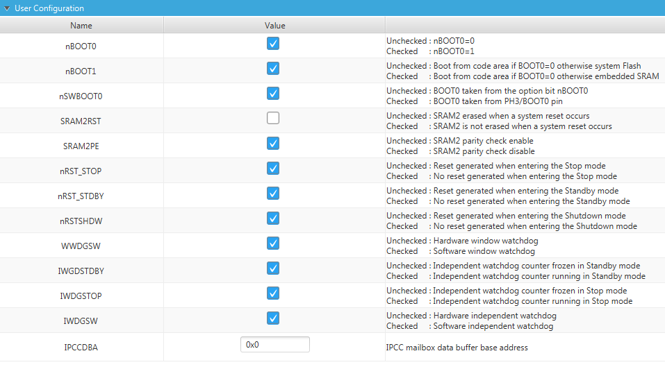

Last point: could you provide me the values of all the option bytes. Just to check if the BOOT0 is set to 1.
Is it your own board or an ST boar (Nucleo or dongle)?
ANist
0690X000009jLXRQA2.pngHey @Remi QUINTIN​ , we are using a custom board.
Option byte boot0 is set from what I see, in the picture the user option bytes that I read from cubeProgrammer in dfu mode.

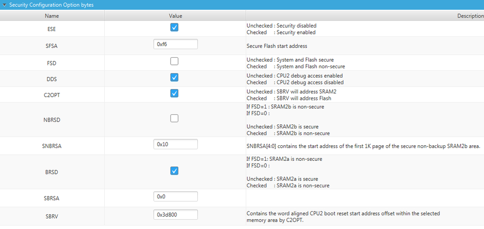

ANist
