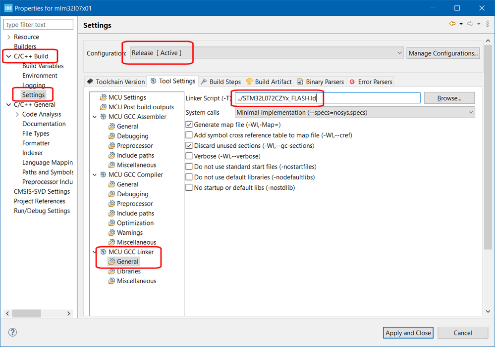

The 'Debug' configuration builds OK, but the 'Release' fails with:
make: *** No rule to make target '../STM32L072CZTx_FLASH.ld', needed by 'mlm32l07x01.elf'.  Stop.
The problem is that there is, indeed, no such file as STM32L072CZTx_FLASH.ld - only STM32L072CZYx_FLASH.ld
The 'Debug' build uses STM32L072CZYx_FLASH.ld - hence it succeeds.
Andrew Neil
The solution is simply to change the Linker File specified for the 'Release' configuration:
0693W00000AOLLSQA5.pngThe 'T' in the part number just indicates the LQFP package option; 'Y' indicates WLCSP - none of which should be of any concern to the Linker.
