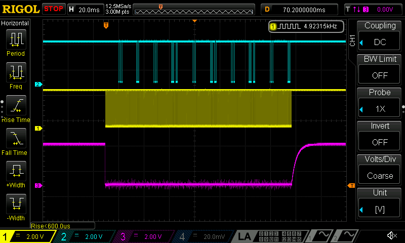

L.E:
0693W000005BPCTQA4.pngI just checked and the NRST, SWCLK and SWDIO on STM32WB55 pins (removed the rf shield). With other STM32 chips when under the reset the MCU was recoverable no matter the user settings was for the GPIOs.
