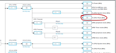

Just a sanity check really.
I'm using the DWT unit to time a chunk of code, am I right that each tick is at 1/32MHz?
The DWY CYCCNT tick rate will be the same as the core clock. By default, it is 32 MHz.
