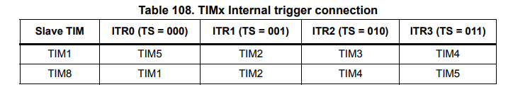

I am aware there is a datasheet, but it does not contain the info I need. I am trying to configure timer triggered timers for my project, so I would like to know the internal trigger mapping for each timer. I am hoping to find something similar to the image below from the STM32F446xx reference manual. Any help is appreciated.

The STM32WB5MMG based on the STM32WB55VGY microcontroller and shared the same reference manual (RM0434). Also, I advise you to refer to the errata sheet for the STM32WB5MMG.

From the web page and the datasheet:
"Based on STMicroelectronics STM32WB55VGY wireless microcontroller..."
