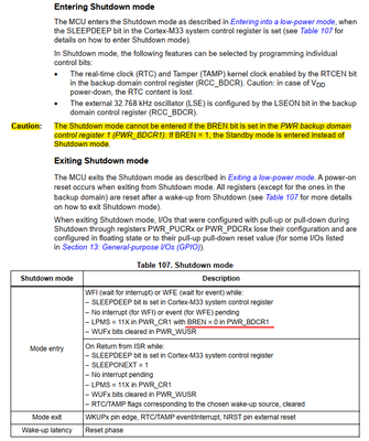

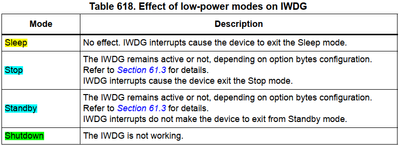

实际上,我想用的是 Shutdown 模式,但是发现 IWDG 在低功耗期间仍然工作,通过查看参考手册,我怀疑进入的是 Standby 模式,所以需要办法来 “冻结” IWDG。我检查了进入 Shutdown 的各项条件,都正常,不明白为什么还会进入 Standby,如果有人知道原因,请及时联系我,谢谢!
English:
Thank ASimo.3! I tried your code, and it works properly on STM32U575RI56!
Actually, what I intended to use was the Shutdown mode. However, I found that the IWDG (Independent Watchdog) still operates during low-power consumption. After checking the reference manual, I suspected that the device entered Standby mode instead. Therefore, I need a way to "freeze" the IWDG. I have checked all the conditions for entering Shutdown mode, and they are all normal. I don't understand why it still enters Standby mode. If anyone knows the reason, please contact me. Thank you!
