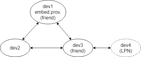

I have a scenario as you can see in the picture below. For creating mesh I am using embedded provisioner (dev1). If I provision dev4, the friendship is automatically established between dev1 and dev4. I want to establish friendship between dev3 and dev4.
What I have to do on the embedded provisioner side or which function should I use on the dev3 to send friend offer to a LPN?
Thank you very much for any advice!

If you reset or switch off dev1, friendship will be established between dev3 and dev4.
Perhaps the best should be to remove Friend feature from dev1.
