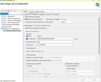

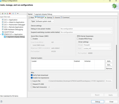

We are using stm32 mcu STM32WLE5JC custom board
below connection we are following for SWD Debugger
ISP1 Pin Connected To Function
1 3.3V VDD (VAPP)
2 PA13 SWDIO (Data I/O)
3 PA14 SWCLK (Clock)
4 NRST Reset (optional but recommended)
5 GND Ground
but while debugging we are getting below error please suggest solution.

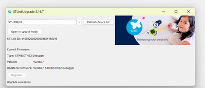

Hi Peter, @AScha.3,
I tied BOOT0 to GND and upgraded the ST-LINK/V2 to V2J46S7 (see screenshot).
However, CubeProgrammer still fails to read the target:
initiativewater_0-1748236433388.pnginitiativewater_1-1748236537040.pnginitiativewater_2-1748236599413.pnginitiativewater_3-1748236692027.png
