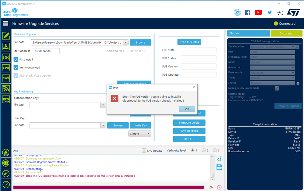

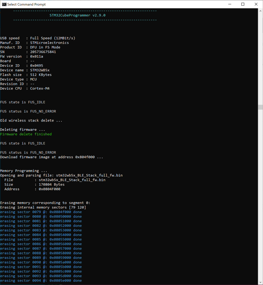

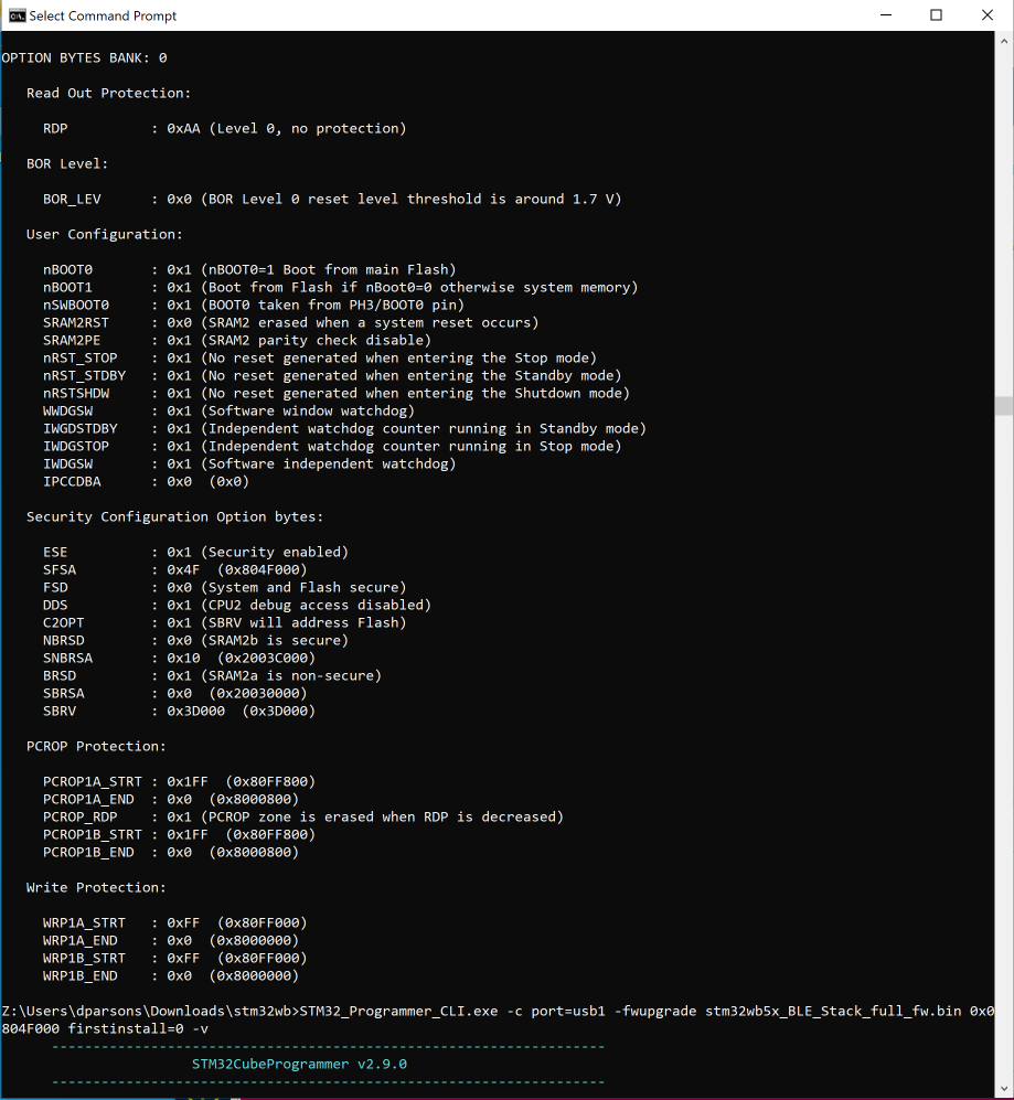

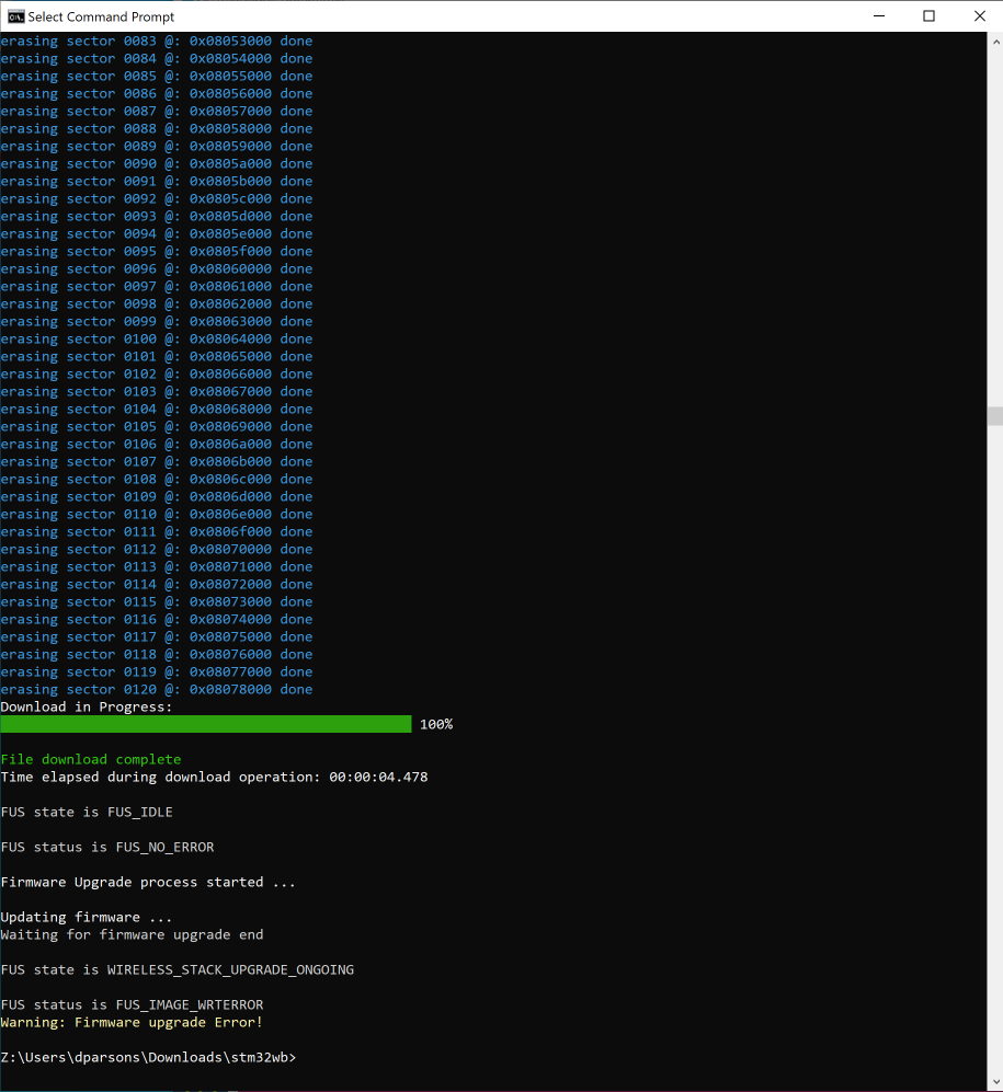

One thing I did notice during command line programming that I hadn't be before is that for the STM32WB5xxE (512K part I'm using) the FUS for 1.12.1 is supposed to be placed at 0x0807A000. I'm loading stm32wb5x_BLE_Stack_full_fw.bin which is 170804 bytes so it takes up 42 memory segments. If I place it at the recommended location of 0x08056000 it erases and programs through section 0x0807F000. Obviously this just writes over the FUS code. So I moved the BLE firmware to 0x0804F000 so that it ends before the FUS. It actually worked on one of the boards that I'm having an issue with but on a couple of others I'm not getting a flash write error (FUS_IMAGE_WRTERROR).
Here's the command line printout:
I actually don't think this is how this works, but I was able to successfully write the BLE firmware by trying different start addresses and different size files (full, light and basic versions of BLE).

Found a solution that worked
FUS_STATE_IMG_NOT_AUTHENTIC error updating FUS from 1.1.0 to 1.2.0 on STM32WB5MM-DK
"I have solved it with a full chip erase. I think it was the option byte nSWBOOT0 set to 1 before the update."
this worked for me and I was starting with 0.5.3 (although a full erase removes that ;)
