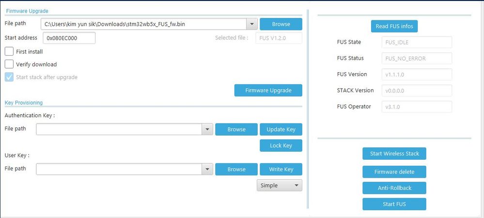

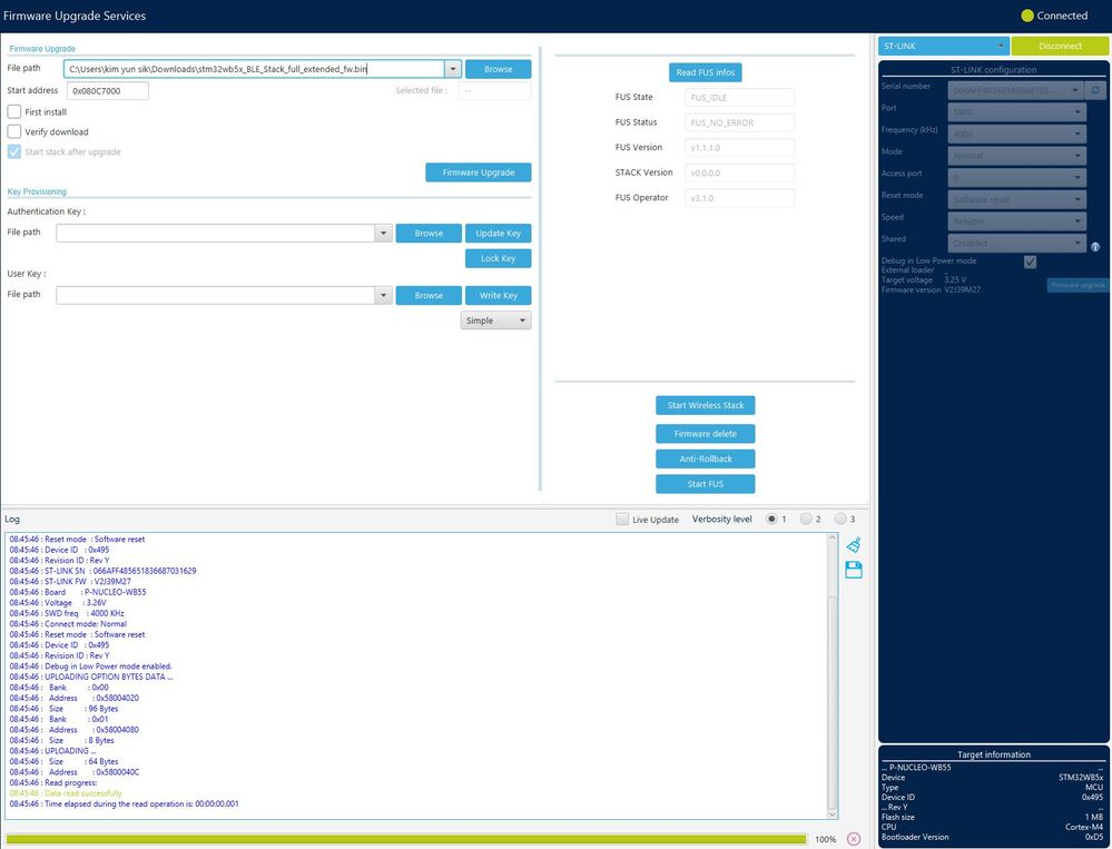

I'm using a custom board with STM32WB55CG. When I uploaded my custom BLE program with STM32IDE, the program could not work. Then I found the chip had an error with FUS and wireless stack. When I read the FUS info, the fus version was v1.1.1.0 and the stack version was v0.0.0.0. 0693W00000NsKFuQAN.jpg
When I push the Start Wireless Stack button, the error with FUS_STATE_IMG_NOT_FOUND was occurred.
Then I tried to upgrade FUS with stm32wb5x_BLE_Stack_full_extended_fw.bin(Release v1.13.3) and encountered with the problems. I tried the upgrade with cubeProgrammer v2.10.0, v2.9.0, and v2.8.0, and it returned the same results.
 09:07:04 : Old Firmware delete ...
 09:07:04 : Warning: Option Byte: nSWboot0, value: 0x0, was not modified.
 09:07:04 : Warning: Option Byte: nboot0, value: 0x1, was not modified.
 09:07:04 : Warning: Option Byte: nboot1, value: 0x1, was not modified.
 09:07:04 : Warning: Option Bytes are unchanged, Data won't be downloaded
 09:07:04 : Time elapsed during option Bytes configuration: 00:00:00.000
 09:07:04 : Succeeded to set nSWboot0=0 nboot1=1 nboot0=1
 09:07:04 : Memory Programming ...
 09:07:04 : Opening and parsing file: 0x495_FUS_Operator.bin
 09:07:04 :  File     : 0x495_FUS_Operator.bin
 09:07:04 :  Size     : 8.00 KB
 09:07:04 :  Address    : 0x08000000
 09:07:04 : Erasing memory corresponding to segment 0:
 09:07:04 : Erasing internal memory sectors [0 1]
 09:07:04 : Download in Progress:
 09:07:04 : File download complete
 09:07:04 : Time elapsed during download operation: 00:00:00.249
 09:07:04 : Application is running, Please Hold on...
 09:07:11 : Reconnecting...
 09:07:11 : Reconnected !
 09:07:11 : Warning: FUS_STATE_IMG_NOT_FOUND, Flash already empty !
 09:07:12 : Firmware delete Success
 09:07:12 : Download Stack/FUS image at address 0x80c7000 ...
 09:07:12 : Memory Programming ...
 09:07:12 : Opening and parsing file: stm32wb5x_BLE_Stack_full_extended_fw.bin
 09:07:12 :  File     : stm32wb5x_BLE_Stack_full_extended_fw.bin
 09:07:12 :  Size     : 177.46 KB
 09:07:12 :  Address    : 0x080C7000
 09:07:12 : Erasing memory corresponding to segment 0:
 09:07:12 : Erasing internal memory sectors [199 243]
 09:07:13 : Download in Progress:
 09:07:16 : File download complete
 09:07:16 : Time elapsed during download operation: 00:00:04.098
 09:07:16 : Firmware Upgrade process started ...
 09:07:16 : Application is running, Please Hold on...
 09:07:28 : Reconnecting...
 09:07:28 : Reconnected !
 09:07:28 : Error: The FUS version you're trying to install is older/equal to the FUS version already installed !

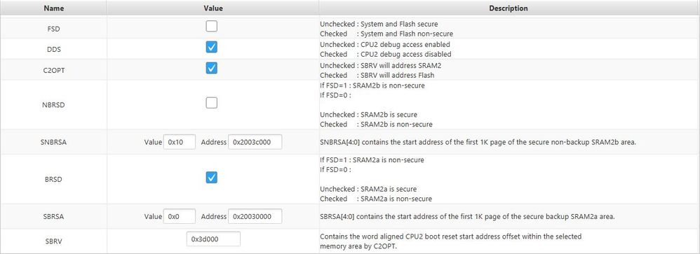

Also, I found some strange things at option bytes. The SNBRSA and SBRSA have different values and addresses from NUCLEO55USB-DONGLE. Here is the picture.
0693W00000NsKGxQAN.jpg​Any suggestions to fix this issue ?​

Kyuns.2
I tried update step by step as the release note. It gave same error.

After and before the upgrade the fus infos was as following picture.
From the log, it seems that StartFus is not activated.
1) WB board connection
2) RDP BB (Level1) Apply -> AA (Level0 ) Apply from OB in STM32CubeProg
After that, try the upgrade again in order.

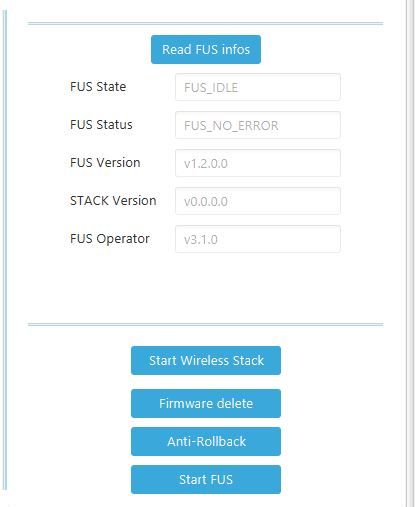

Kyuns.2
I followed your advice and upgraded FUS to v1.2.0 successfully.
0693W00000NsLq3QAF.jpgHowever, when I tried to upgrade BLE stack, the following error was occured.

Remy ISSALYS
You can look this wiki page which describe how to update the FUS and the BLE stack. If your issue isn't resolved, please describe your procedure to update the BLE stack.
