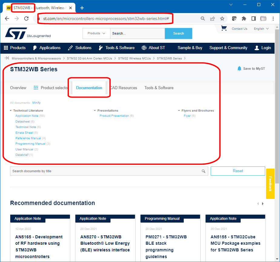

Have you checked out the documentation available?

Many examples of BLE applications are available in STM32CubeWB package:
https://www.st.com/en/embedded-software/stm32cubewb.html
You can look BLE_HeartRate project (Projects\P-NUCLEO-WB55.Nucleo\Applications\BLE\BLE_HeartRate) which allows to do fast and low advertising, see Adv_Request in app_ble.c file.
