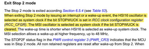

>  I would like to ask how I can switch to the HSI clock after waking up, and then, of course, switch back to the LSE to allow wake-up functionality.
After exiting Stop 2 mode, the clock is either already on HSI or MSI depending on settings.
To switch from those to LSE, configure LSE as the system clock using HAL_RCC_OscConfig same as you do if you select it during startup.

Hi  @TDK ,
Thank you for the reply. Do you mean that if I select the LSE clock in the clock tree diagram for the LPUART, it gets replaced by the HSI after waking up from STOP2 mode?
Ahh, you are asking about the LPUART clock, not the system clock.
LPUART1 can be clocked from LSE in stop2 mode. There are no changes. When it wakes up, it will still be clocked by that clock. If you want to switch it to a different clock, you will need to de-initialize it and re-initialize it with those settings. This has nothing to do with stop 2 mode.
