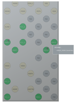

FYI, I can see the memory address from 0x10040000 to 0x100BF800, which means 0x100017d0 is outside of memory.

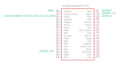

Could you please share the schematics of your board and the connection with your ST-LINK.
Best Regards.
STTwo-32
‎2025-01-10 7:39 AM - edited ‎2025-01-10 7:44 AM
This is all I can share. Unfortunately, I'm not suing RST (B5) pin of this microcontroller.
‎2025-01-10 8:11 AM
This is the same behavior mentioned on the previous link. The RSTN pin should be linked to the NRST pin of your ST-LINK.
Best Regards.
STTwo-32

Thanks. Now IDE is working now by connecting NRST to RST.
