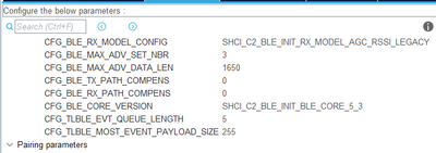

You can change the version of Bluetooth in the CubeMX if i am not wrong. so stm32wb5mmg does support bluetooth version 5.4 and for stm32wb1mmc , It supports bluetooth 5.4 as well. all you need is, when you are doing settings for your project

As said @SikandarLF both STM32WB1MMC and STM32WB5MMG support both BLE 5.4. But, you can configure them to use even a lower version for maybe adaptation needs.
Best Regards.
STTwo-32
Please don't be confused between Bluetooth version and real Bluetooth features supported.
Every features are optional, meaning you can have a device Bluetooth 5.4 certified but supporting only features of 5.1 for example.
Please refer to Certification guideline for STM32WB and STM32WBA - stm32mcu for having latest certification version of stm32wb5mmg or stm32wb1mmc.
As can be seen here, STM32WB5MMG is having a 5.3 component QDID (187035) and can be combined with a stack version 5.4 (QDID 216169) so this module can be stated as bluetooth 5.4 (again does not mean it supports all 5.4 features)
STM32WB1MMC is having a 5.3 component QDID (187042) and can be combined with a stack version 5.4 (QDID 216169) so this module can be stated as bluetooth 5.4 (here again does not mean it supports all 5.4 features)

With your help, I have accurate information.
I was able to set the Bluetooth version through CUBEMX.
It helped me solve my problem
