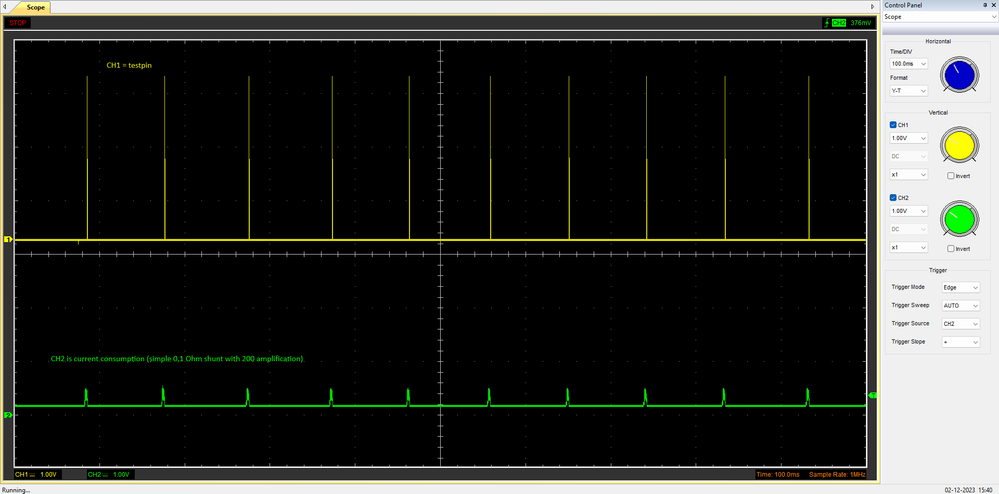

If I go to the file stm32_lpm_if.c and edit:
static void EnterLowPower(void)
* This function is called from CRITICAL SECTION
HAL_GPIO_WritePin(testpin_GPIO_Port, testpin_Pin, 0);
and
static void ExitLowPower(void)
HAL_GPIO_WritePin(testpin_GPIO_Port, testpin_Pin, 1);
/* Release ENTRY_STOP_MODE semaphore */
then I can see that each 100 ms (advertising interval), the microcontroller wakes up (current spike and test pin goes high)
and then goes back to sleep (test pin goes low).

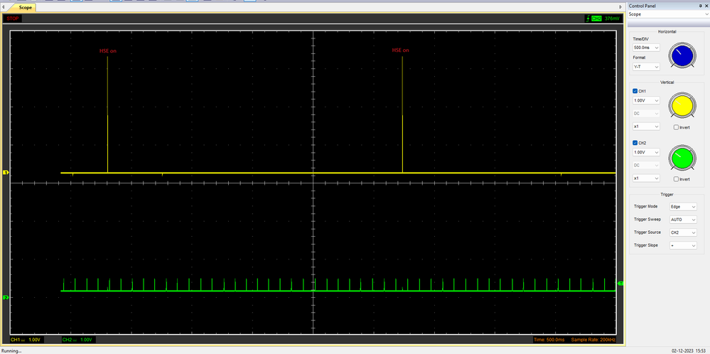

But if I remove the testpin write and add it here:
static void Switch_On_HSI(void)
and here
LL_HSEM_ReleaseLock(HSEM, CFG_HW_ENTRY_STOP_MODE_SEMID, 0);
while(LL_HSEM_1StepLock(HSEM, CFG_HW_RCC_SEMID));
if(LL_RCC_GetSysClkSource() == LL_RCC_SYS_CLKSOURCE_STATUS_HSI)
/* Restore the clock configuration of the application in this user section */
/* USER CODE BEGIN ExitLowPower_1 */
LL_RCC_HSE_Enable( );
__HAL_FLASH_SET_LATENCY(FLASH_LATENCY_1);
while(!LL_RCC_HSE_IsReady( ));
LL_RCC_SetSysClkSource(LL_RCC_SYS_CLKSOURCE_HSE);
while (LL_RCC_GetSysClkSource( ) != LL_RCC_SYS_CLKSOURCE_STATUS_HSE);
/* USER CODE END ExitLowPower_1 */

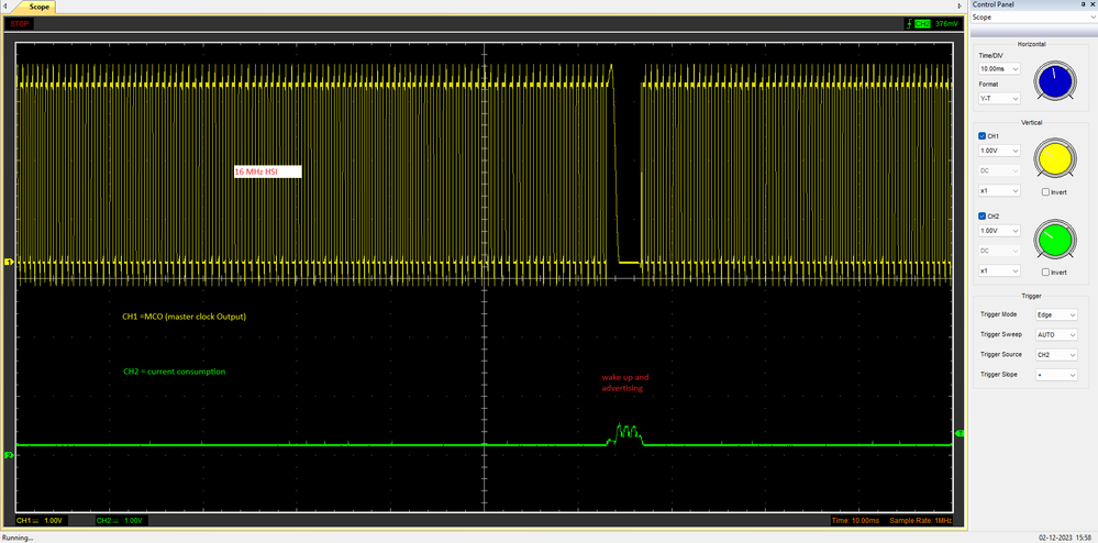

then I observe, that the HSE is only turned on each 2,4 seconds.
I thought the procedure is:
Switch to HSI, go to sleep,
wakeup, turn on HSE, wait till it is ready, send advertisement package
swtich to HSI, go to sleep and so on.
From the readings on the oscilloscope, I cannot confirm that the HSE is turned on each 100 ms, as I would suppose it would be.
Also, when I monitor the MCO output (I output the HSE to a pin), it shows the HSI clock during sleep, but during the advertising there seems to be no clock signal on MCO pin (with prescaler = 16).
Btw. all these measurements are done during debugging.
Sorry for the bad quality of the oscilloscope, I am using relatively simple equipment and an improvised test setup.
Kind regards
René
