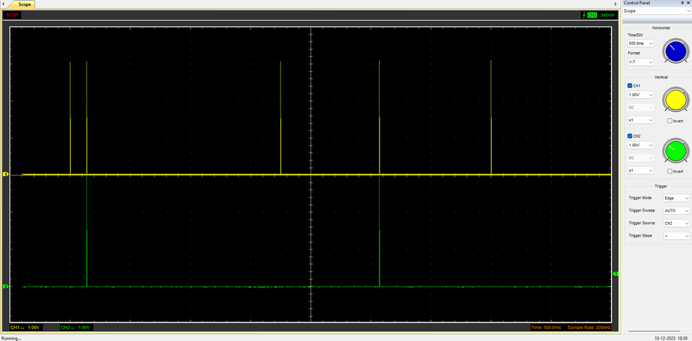

Here´s a test with an oscilloscope:
Channel 1 (yellow) shows a spike each time the HSI is started.
Channel 2 (green) shows a spike each time the HSE is started.
Advertising interval is ~1,7 s. A software timer triggers a task each 2,5 s.
You can clearly see, that during advertising, there is no spike for the HSE, only for the HSI.
For the task, however, first there is a spike for the HSE (microcontroller wakes up and executes a task), directly followed by the activation of the HSI (for sleep).
I can observe this behavior with and without the debugger connected.

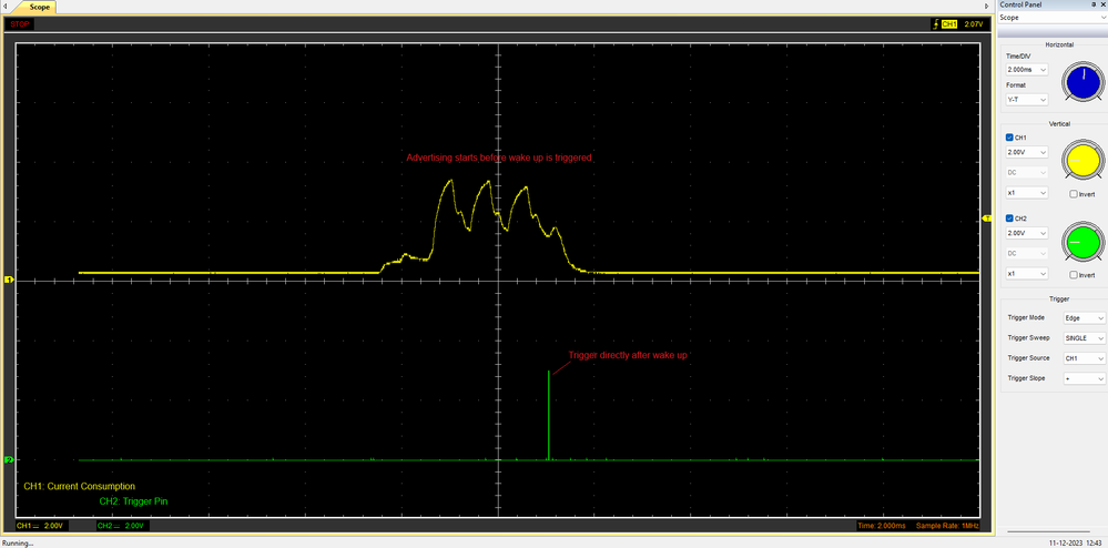

Ok, I did some more testing.
I think I observed that the HSE is activated before CPU1 wakes up from sleep mode.
CPU1 does wake up from sleep mode after advertising.
I set a test pin (LED_FLASH) high and low directly after _WFI(), so I can see when the microcontroller wakes up.
void PWR_EnterStopMode(void)
/* USER CODE BEGIN PWR_EnterStopMode_1 */
/* USER CODE END PWR_EnterStopMode_1 */
   * When HAL_DBGMCU_EnableDBGStopMode() is called to keep the debugger active in Stop Mode,
   * the systick shall be disabled otherwise the cpu may crash when moving out from stop mode
   * When in production, the HAL_DBGMCU_EnableDBGStopMode() is not called so that the device can reach best power consumption
   * However, the systick should be disabled anyway to avoid the case when it is about to expire at the same time the device enters
   * stop mode (this will abort the Stop Mode entry).
  HAL_SuspendTick();
   * This function is called from CRITICAL SECTION
  EnterLowPower();
   * ENTER STOP MODE
  LL_PWR_SetPowerMode(LL_PWR_MODE_STOP2);
  LL_LPM_EnableDeepSleep(); /**< Set SLEEPDEEP bit of Cortex System Control Register */
   * This option is used to ensure that store operations are completed
#if defined (__CC_ARM)
  __force_stores();
#endif
//  LED_FLASH_GPIO_Port->BRR = (uint32_t)LED_FLASH_Pin;
  __WFI();
/* USER CODE BEGIN PWR_EnterStopMode_2 */
  LED_FLASH_GPIO_Port->BSRR = (uint32_t)LED_FLASH_Pin;
  	    for(uint32_t i; i<32; i++)
  		    __asm__("nop");
/* USER CODE END PWR_EnterStopMode_2 */
  return;

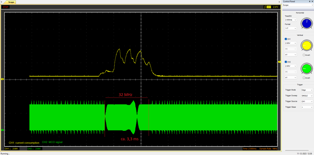

I also measured the current consumption, so I can see when the microcontroller is advertising.
Interesting to see is that the microcontroller seems to stars advertising before CPU1 wakes up.

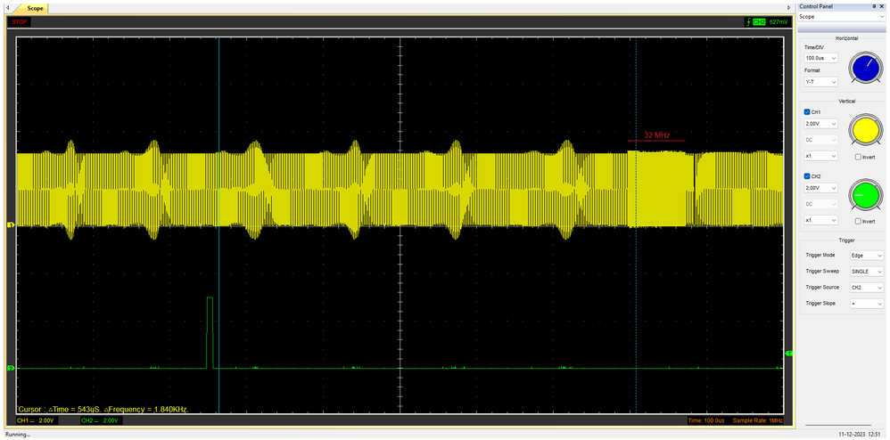

I also connected CH1 to the MCO to observe the clock change:
How does it do that? I thought the HSE is "actuated" by the CPU1? Here we clearly see, that the HSE is running before CPU1 wakes up, which confirms my findings from previous posts.
If I wake up the microcontroller with a timer task, then it first wakes up and then starts the HSE:
