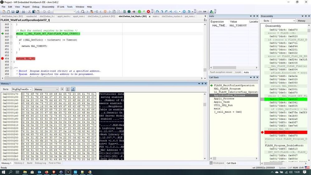

I am trying to develop app based on BLE_MeshLightingProvisioner example.
From the readme file, I know that the node can be self provisioned and configured when the ENABLE_PROVISIONER_FEATURE is defined. This is a great feature and I want to use it.
So I uncommented ENABLE_PROVISIONER_FEATURE define.
In this example, there is a problem with FLASH access. As can you see on the screenshot AppliPrvnNvm_Process tries to save data but it is always HAL_TIMEOUT.
After more tests I can see when microcontroller is fully cleared (RDP -> 0xBB -> 0xAA) this function works properly and returns HAL_OK.
But after reset there is always HAL_TIMEOUT returned.

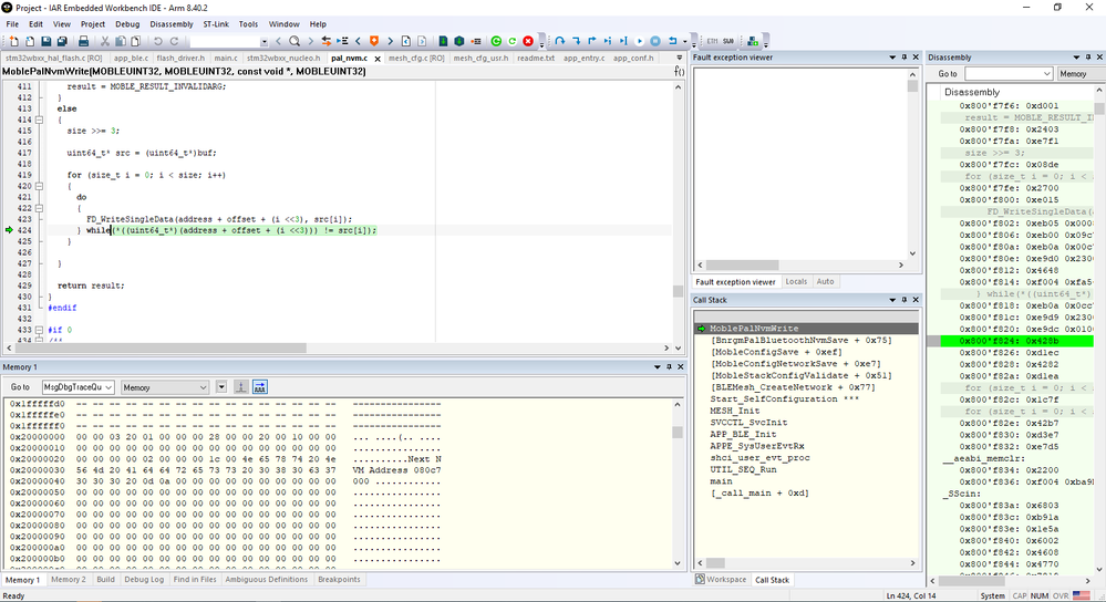

The next problem with FLASH access is that I can not write my data to FLASH.
In the cube version 1.6.0 there is provided an example BLE_RfWithFlash with flash_driver.c.
The new flash driver should provide correct synchronization between the two cores during flash access.
I made the following changes based on this example.
Inside my mesh app I change MoblePalNvmWrite and MoblePalNvmErase using functions from flash_driver.c. Please look at the code below.

MOBLE_RESULT MoblePalNvmWrite(MOBLEUINT32 address,
MOBLEUINT32 offset,
void const *buf,
MOBLEUINT32 size)
MOBLE_RESULT result = MOBLE_RESULT_SUCCESS;
if (offset > NVM_SIZE)
result = MOBLE_RESULT_INVALIDARG;
else if (size == 0)
result = MOBLE_RESULT_FALSE;
else if (offset + size > NVM_SIZE)
else if (offset & 3)
else if (size & 3)
else
size >>= 3;
uint64_t* src = (uint64_t*)buf;
for (size_t i = 0; i < size; i++)
do
FD_WriteSingleData(address + offset + (i <<3), src[i]);
} while(*((uint64_t*)(address + offset + (i <<3))) != src[i]);
return result;
I also call SHCI_C2_SetFlashActivityControl(FLASH_ACTIVITY_CONTROL_SEM7); at the end of void APP_BLE_Init( void );

On the screenshot you can see endless execution do {} while() because of flash write fails.

‎2020-04-28 1:48 AM
​Hello,
You cannot set the 2 features ENABLE_PROVISIONER_FEATURE and DYNAMIC_PROVISIONER at the same time.
Perhaps it is not clearly explained in the readme.txt file.
It seems that with the ENABLE_PROVISIONER_FEATURE, some FLASH trouble access happens after each reset of the board, this trouble will be solved in the next releasee.
Nevertheless the BLE_MeshLightingProvisioner project is an example of embedded provisioner, the default configuration settings of this project is the Dynamic provisioner.
In this configuration the FLASH accesses works.
The Dynamic provisioner feature is not so different than the provisioner feature, the diffference is that after initialization the device is seen as an unprovisioned device.

315710 ConfigClient_ChkRetries - Retry started
317710 ConfigClient_CompositionDataGet - Config CompositionDataGet Message
337710 ConfigClient_ChkRetries - Retry started
339710 ConfigClient_CompositionDataGet - Config CompositionDataGet Message
359710 ConfigClient_ErrorState - No response from Node
