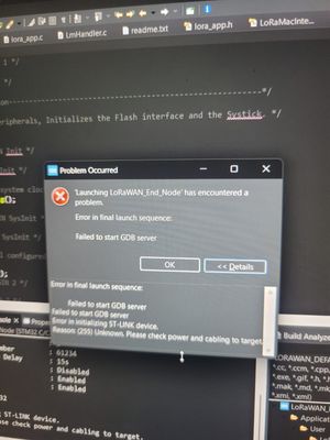

    I have ordered and received two B-WL5M-SUBG1 boards for my testing. I am able to flash one B-WL5M-SUBG1 board. When I am trying to flash the another B-WL5M-SUBG1 board, I am getting this below error. Seems like HW issue or something else? Could you please help me to rectify this issue?

The message tells you that it failed to initialise the ST-Link.
What ST-Link are you using?
The message also tells you to check power and cabling - have you done that?

Prabakaran
I am using STLINK-V3MINIE In-Circuit Debugger And Programmer and also I am using the same power and data cable which I using for the another board. So one B-WL5M-SUBG1 board is working and another B-WL5M-SUBG1 board is not working and getting the above error
