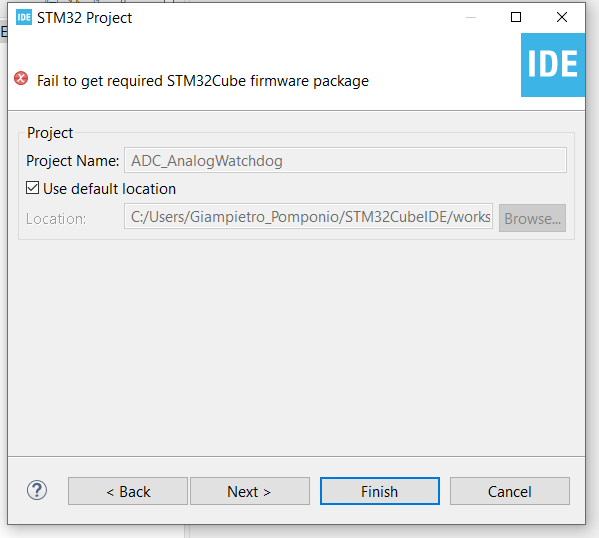

Anyone know how to resolve a "fail to get required stm32cube firmware package" error when importing a new project?
GPomp.1
I'm trying to import an example project for STM32WB using STM32CubeIDE V1.5.1
and got the following error:
0693W000007YzafQAC.pngI tried doing package updates, uninstall and reinstall and everything I could think of but I wasn't able to figure out how to resolve this (tried googling/forum searching it but no luck).
Following I report you the Package installed:
How can I resolve this issue?

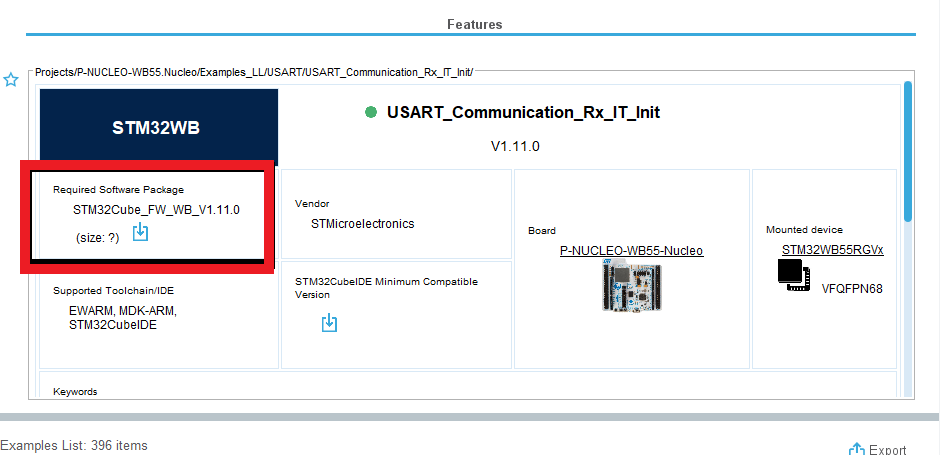

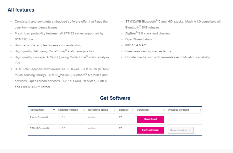

I've noticed that the required software package is 1.11.0
But the lastest release downloaded from the ST'site or STM32Cube is 1.10.1:
someone has the same problem? Any ideas to solve this problem?

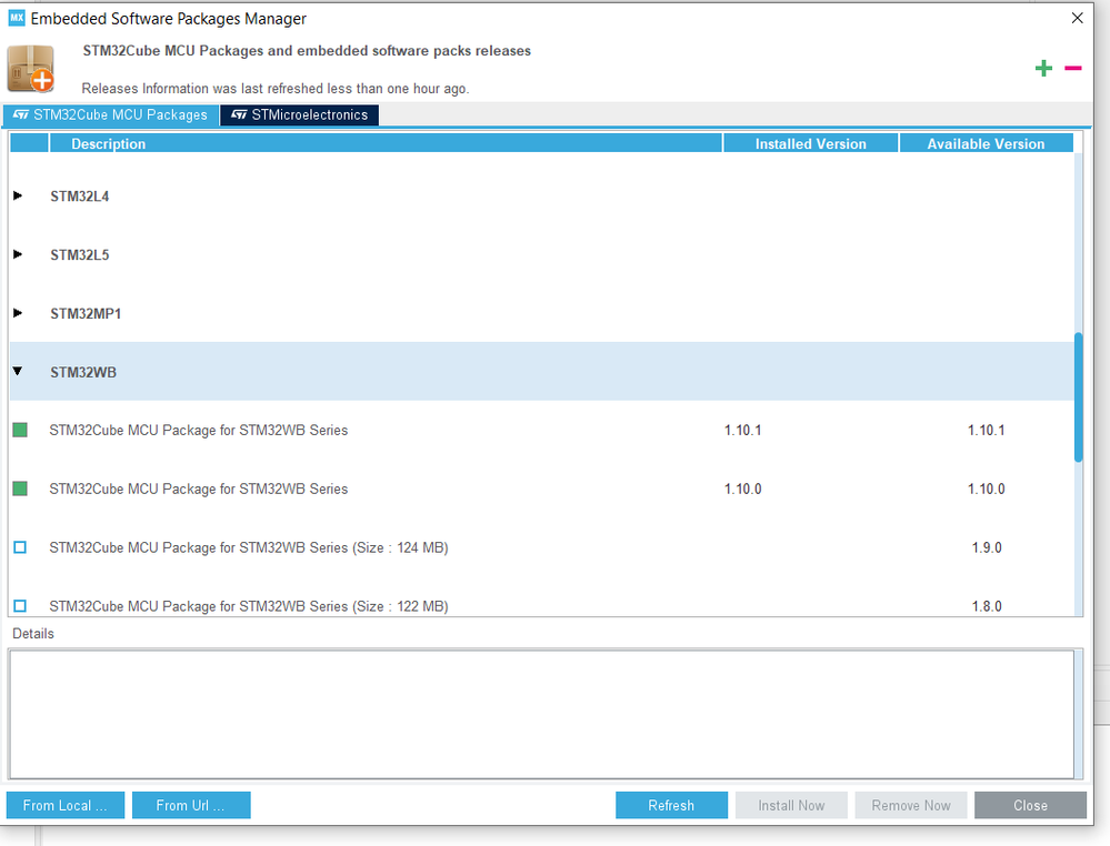

I open STM32CubeIDE and click to Help->Manage Embedded Software Packages.
After I click on the button 'Refresh'. The procedure go on without error (I don't have connection problem) in fact I've seen that the download procedure is done but the last release downloadable for the series STM32WB is 1.10.1 yet.
Is it right the procedure that I've done?
Thanks for your contribution,
Giampietro
Hi again @Community member​ ,
Yes, everything is ok, the STM32WB 1.11.0 firmware version will be available for the next CubeMX and CubeIDE releases.

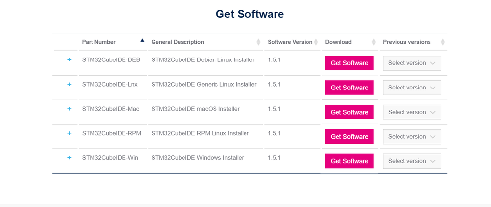

When the new release for CubeIDE is available?

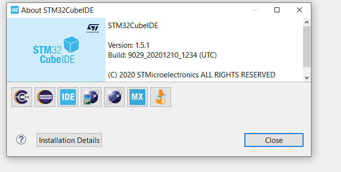

I've now checked the last downloadable is 1.5.1 (my current version) yet.
Giampietro
Hello @Community member​ ,
The next CubeIDE and CubeMX releases will be available to download from st.com at the end of this week.
