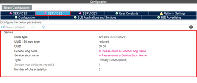

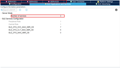

On the BLE Applications and Services tab, you have to select the number of services you want to implement. Once this is done, N new tab will be added to your configuration view (N is the number of services you selected):
On each of the new tab you can configure the service you are looking for:

Is "Number of services" where I add new services? (Please see the attachment.)
Is there an item called "Add Custom Service"?
If possible, please show me with a screenshot.

I understand that the normal way to add services is "Number of services".
