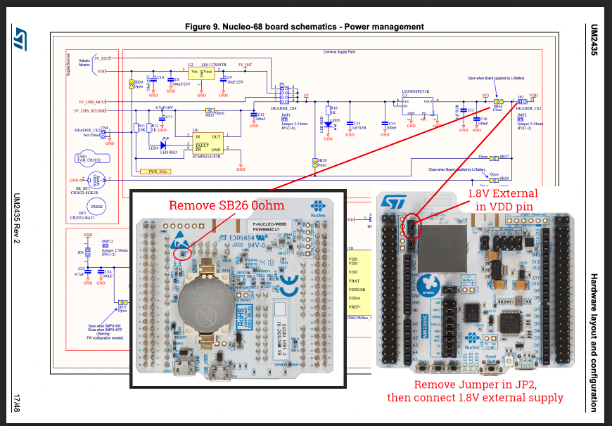

Is there a way to use 1.8V NAND Memory Chip using Quad SPI GPIOs in STM32WB55 Nucleo Pack?
- I already wired-up the 1.8V NAND chip and connected to Quad SPI pins of the Nucleo Pack, but I haven't powered this board up yet.

‎2022-03-15 9:53 PM
Finally, I was able to convert the board to have 1.8V in GPIOs.
The idea is based on the user manual's Power management instruction, wherein to take in external 1.8V supply and bypass the PM components related to USB voltage input.

‎2022-03-15 12:05 PM
There is a 1.8V pin in the Nucleo Pack, and there is also a VDD for the STM32WB55.
Can that that 1.8V be connected to VDD (or Reference pin) so the GPIOs will be on 1.8V?

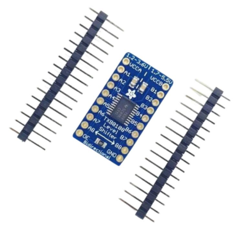

‎2022-03-15 12:11 PM
For the level shifter, is this viable? TXB0108?

‎2022-03-15 12:31 PM
I’m not sure on the 1.8V questions. I would consult the schematics to verify the 1.8V pin is a viable supply and that the voltage is indeed 3.3V.
The level shifter data sheet should list bandwidth limits. I can’t imagine it being hard to find one for 40MHz.
