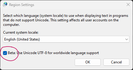

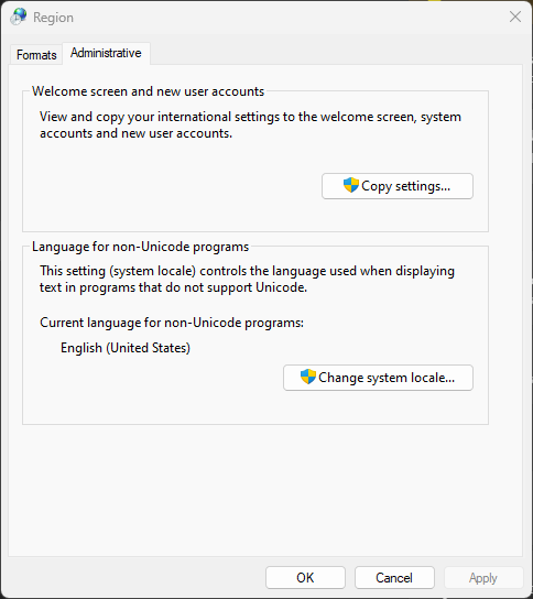

NSeba
June 20, 2023
Update: Mine started working after I made UTF-8 system wide.
I don't know what trouble it is going to make with other applications
