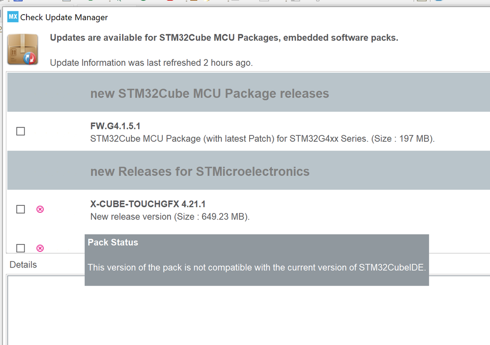

Nice but is compatible with 1.11 IDE ? My 1.10.1 say no
Osman SOYKURT
January 23, 2023
Hello MM..1,
Can you send us a screenshot of the message you have on STM32CubeIDE please?
/Osman

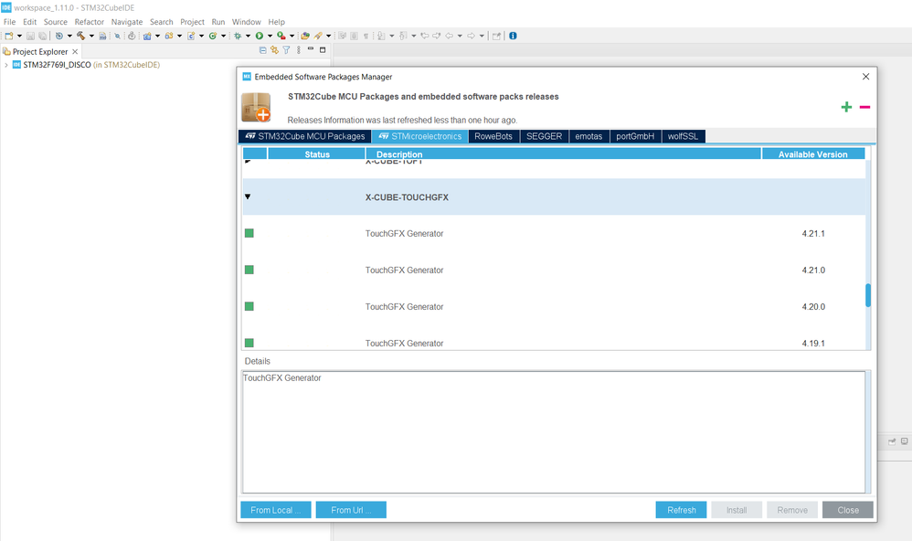

Chief III
January 23, 2023
