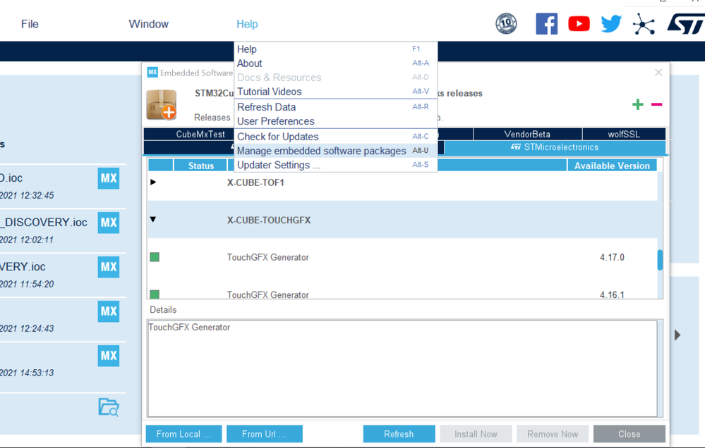

How do I upgrade my existing touchgfx? Do I need to uninstall current one first?
You do not need to uninstall the current one. You can download the latest version of TouchGFX through this official link. Just press the "Get Software" purple button.
You can also download it through STM32CubeMX. In the landing page when opening STM32CubeMX go to the "Help" tab and click on the "Manage embedded software packages". The STMicroelectronics tab will show all the available ST external tools like TouchGFX, with all available versions (TouchGFX 4.17 in my screenshot is not available to the public yet) .
