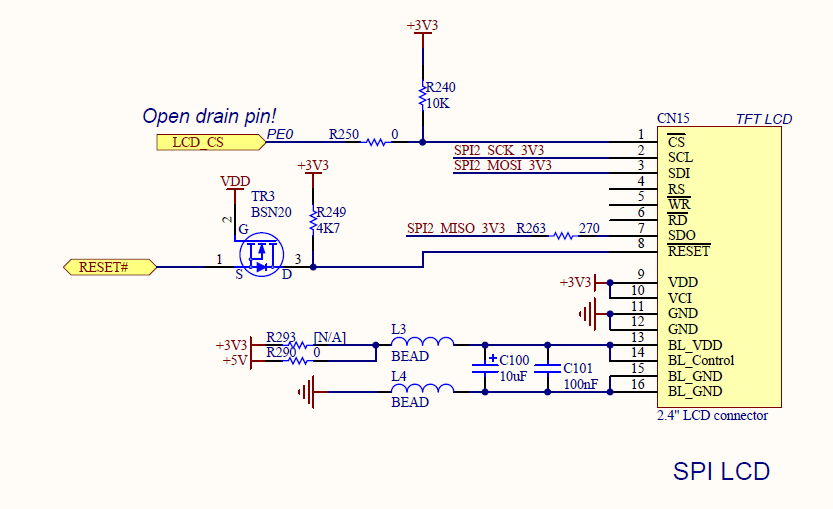

which lcd is mounted on the STM32303E-EVAL board ? How do i get to know its model number and are there any example programs to run it with ?

Hello @CJaid.1​ ,
240x320 TFT color LCD connected to the SPI interface.(user manual : UM1807 section 2.20 Display and input devices)

Hello.
Yes, I have the BSP and the user manual, but there is not much data about the LCD and what is the part name/ model number of the lcd so that i can use the respective bsp file.
Also, are there any sample programs where i can get some examples.
It's a 240x320 TFT LCD with SPI.
Aren't the part numbers called out in the Bill Of Materials (BOM) under the CAD Resources tab of the product page?
8001049,1,LCD 2.4 inch 143.6mmx85.5mmx4.34mm,CN3,,,"AMPIRE CO.,LTD",AM240320LGTNQW-00H,,,,,,ST,lead free,,serial
8001050,1,LCD 2.4 inch 143.6mmx85.5mmx4.34mm,CN3,,,"AMPIRE CO.,LTD",AM240320LGTNQW-01H,,,,,,ST,lead free,For all products except STM32L152D-EVAL,parallel
8001038,1,LCD 2.4 inch 143.6mmx85.5mmx4.34mm,CN3,,,"AMPIRE CO.,LTD",AM-240320LDTNQW-05H,,,,,,ST,lead free,For STM32L152D-EVAL only,parallel
https://www.eurocomposant.fr/pub/media/pdf/AM-240320LGTNQW-00H-A.pdf
https://www.ampire.com.tw/en/index.asp
