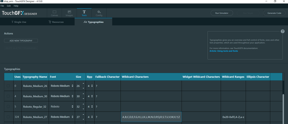

Yes Sir you are right. I am trying to print a unsigned char array (String) in touchgfx from an another C file. But In display it is reflecting as ????.So I went through your forums it was recommended to use strcpy to solve the issue.....That's why ? The hierarchy is I am sending the unsigned char array to wchar_t * and then I am printing it in screen (under touchgfx Files)
? means the characters are not generated by touchgfx. You need to put in any wildcard characters you want generated (so you dont have all glyphs from all your fonts creating a huge application).
RG.3
0693W000006FKfxQAG.pngI have included in wildcard Characters. But still the problem exists
Check your generated files in generated/fonts source files - Are the unicodes there?
Did you make sure to invalidate the textarea after updating its wildcard buffer?
RG.3
Problem Solved I understand. How it works....Thanks a ton sir!
