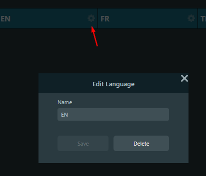

I had to spend some time to analyze the issue but I was able to fix it. Here is the description:
In Touchgfx version 4.16, the Touchgfx tool allowed to change the language name after it was created. Like here
0693W00000BdFLpQAN.pngTherefore in our application, we had the default language name changed from GB to EN.
I assume while performing the upgrade in Touchgfx 4.17.0 tool, the touchgfx looks for GB language in the texts.xlsx and when it doesn't find the GB key, the upgrade is aborted with the above error.
Hence I manually opened the text.xlsx and renamed EN to GB. Thereafter the upgrade to 4.17.0 was successful.
I am not sure if there are multiple causes for the above error.
