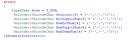

In model.hpp I create struct of unicodechar elements and update them in to view screen. But sometimes I faced with this bug. In struct I define like this:

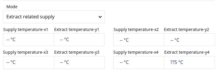

_legacyfs_online_stmicro_images_0693W00000bjeYBQAY.pngbut in view screen I get:
When I write in array :

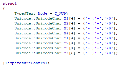

_legacyfs_online_stmicro_images_0693W00000bjeYzQAI.pngIn the last element Y4 I get random value:
_legacyfs_online_stmicro_images_0693W00000bjeZ9QAI.pngMaybe someone have this bug and solved it?

Perhaps you use array[6] instead of array[4]. Look at your struct

:D It's not that problem

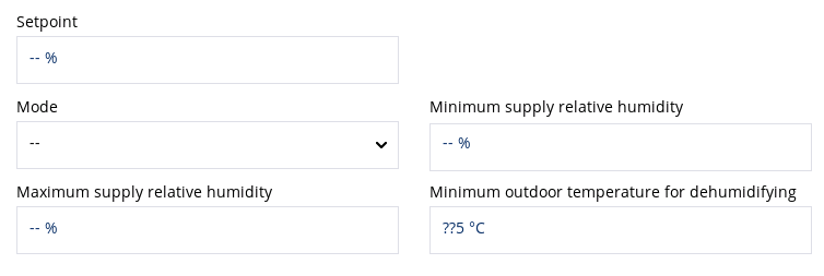

I've noticed that this bug appears in last struct element

_legacyfs_online_stmicro_images_0693W00000bjfttQAA.pngeverywhere same problem

Try moving TypedText to the end of struct
