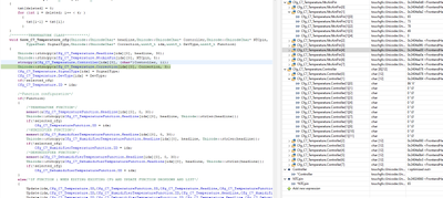

I'm trying to pass wildcard buffer to model.hpp and convert Unicode::UnicodeChar to char and I'm using strncpy.  But it copies only one character.. Where is problem here?
Also if I copy Unicode::UnicodeChar to Unicode::UnicodeChar buffer it works good.

maybe you should use toUTF8-function since your source is unicode (i guess) and destination is char or just copy it in for loop.
Strncpy works unicode to unicode or char to unicode.
