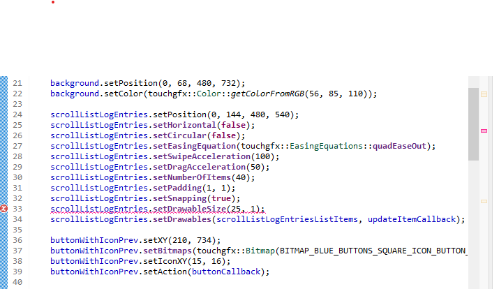

After updating TouchGFX to 4.20, my auto-generated file for <screen>ViewBase.cpp is resulting in an undefined reference to setDrawableSize:
0693W00000QMIfoQAH.pngThis is for a scroll list I have on one of my screens. Has anyone else had this issue? I'm wondering if it's a bug. I was previously at 4.18.

Yes. I have tried a multitude of different things trying to find the magic solution. This is undoubtedly tied in with the other problems I have been having with the upgrade of my project to 4.20. I have a case with tech support (00161718). This is the only error showing in the Project Explorer with a red icon, but there are actually over 50 undefined references I do not know how to get rid of.

FYI, in the 4.18 online documentation, setDrawableSize isdeclared a void function. In the 4.20 documentation, it is declared a virtual void function. However, this being an auto-generated call, I would expect that the code generation software would handle it as needed.

The only red X icon I get in my project is on the setDrawableSize auto-generated call as shown in the earlier post. However, I get 52 link errors in total, which are listed in the attached log file.
If I can get the answer on how to resolve these errors, I can move on, after three days of messing with this.
Note: one thing I noticed in the online documentation is that in 4.20, setDrawableSize is a public function of the ScrollList class, and is declared as:
virtual void setDrawableSize(int16_tdrawableSize ,int16_tdrawableMargin)
and in 4.18, it is a public function inherited from ScrollBase, and declared as:
void setDrawableSize(int16_t drawableSize, int16_t drawableMargin)

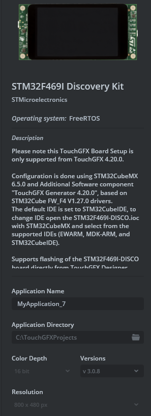

I tried creating a new TouchGFX project based on the STM32F469i-DISCO board. In the description to the right when you select the board, it gives the following information:
0693W00000QMOoIQAX.pngCould the fact that I installed CubeMX 6.6.1, and which uses FW_F4 V1.27.1, be causing any issues? Incompatible with the board setup, perhaps?
