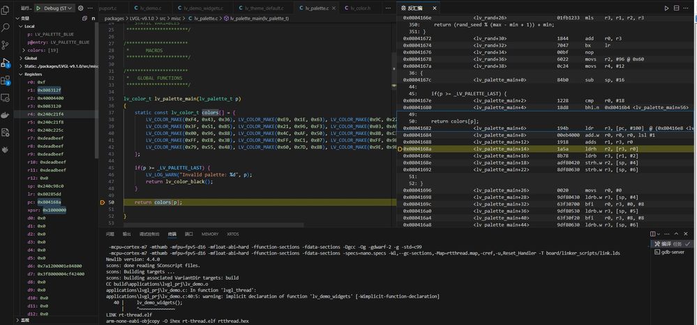

Use sthm32h7b0 to push 800*480 TFT screen, using internal ram,using RGB565 color space. Run the test function lv_demo_widgets(), it can work normally under lvgl8.2. fter lvgl was upgraded from version 8.2 to version 9.1, after modifying the corresponding driver file, run the lv_theme_default_init function under the lv_demo_widgets function, and hardfault occurs.

usage fault:
SCB_CFSR_UFSR:0x100 UNALIGNED
Specifically locate the lv_palette_main function, and a non-alignment error occurs when returning.The location where the hardfault occurs is as follows:
typedef struct {
    uint8_t blue;
    uint8_t green;
    uint8_t red;
} lv_color_t;
lv_color_t is changed to 3 bytes. return colors[p]; When the statement runs, a hardfault occurs when half-word is loaded from address 0x8084d7F to register R2.
The value of SCB->CCR is 0x70200

I would like to ask everyone, can stm32h7 not access the internal Flash in an unaligned manner? Is there any way to solve this problem?
