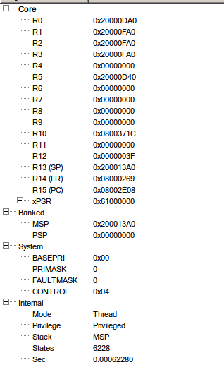

Have you tried to decode the SCB register values after the crash ?
They should tell you about the cause.
Perhaps you have FreeRTOS configured to use MPU sections, or got a stack overflow.

In the debug screen I have the following registers shown.
I am using Keil

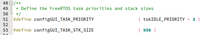

Also I am not changing the configuration of GUI Task , I am using templates provided in TouchGFX designer ,,
No, the SCB registers, like here:
http://www.keil.com/appnotes/files/apnt209.pdf
