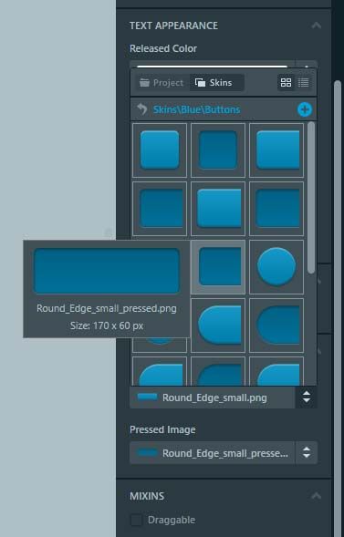

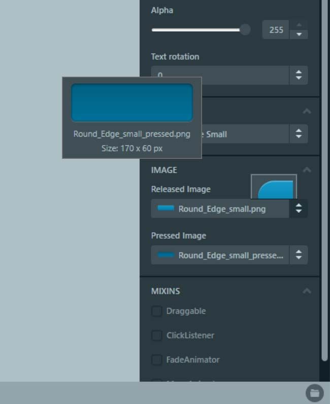

Just to give you an idea what the issue is, here are two screen shots. The first one is taken with 4k (scaling factor is 150%), the second one is taken with full HD (scaling factor 100%). You can see that for 4k the tiles for selecting the image have almost entirely disappeared, only one tile is displayed, but that one you can never select with the mouse cursor, since it will disappear before you can reach it. Similar things happen for example when trying to select a color. You will never be able to successfully enter a number for the colors.
The issue seems to be the scaling factor. If I set it to 100% instead of 150%, then everything works; just now the text is so small that I have issues reading it (there is a reason why Windows recommends a scaling factor of 150% for this 4k display, and I agree...). So I recommend that you check the implementation of the UI for the use of the scaling factor. It is evidently missing somewhere.

FWIW, I have a 4K monitor and cannot reproduce your issue at 125% or 150% (photo taken at 150%).
