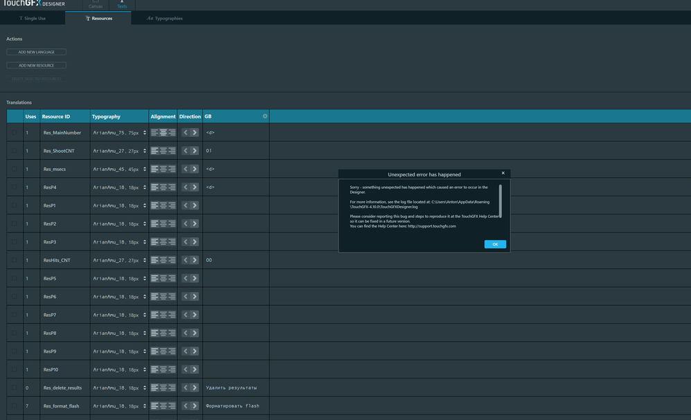

When I go to Texts->Resources and scroll to bottom, I got this error and all Resource ID values randomly changes.
I upload log file for you see.

It is possible for you to share a screenshot of this issue or even share the project, then we can try and reproduce this on our side.

I guess the problem is in space symbol on ResP1,ResP2 and etc
I changed it to "0" and looks like problem solved.
But need to test more

@Anders Nedergaard PETERSEN​ now problem comes after I change Typography of resource id and scroll

I'll run the log by our designer people on monday. Which language in windows are you using?
/Martin
Russian language.
Can you share this project?
/Martin
What files/folders you need?
and give me your email to send it.
