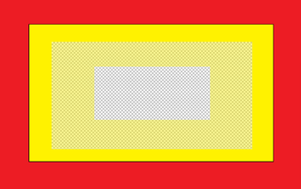

Indeed the transparent hole in the center does not show the content, you need to have skin that has no transparency at the position of your simulator.
In the example above, the red zone is the border of your skin, the yellow zone is zone that will be visible from your simulator. The transparent and semi-transparent will not be displayed at all.

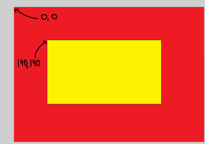

Concerning what's written in our documentation : "The X and Y properties determine the position of the simulator on the skin." There's no problem with that sentence.
On the example above, if I want to place my simulator on the yellow zone, I'll put an X and Y with positive value, for instance coordinate 140,140. The origin (0,0) is placed on top left corner of my skin (same as TouchGFX coordinate, so in the red zone, top left.
Hope it helps.
