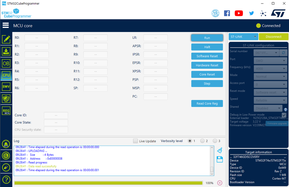

Only the "touch screen" doesn't work.
My board doesn't work with hardware reset, but it works with STM32CubeProgrammer.
0693W00000WIjV8QAL.pngWhat is the reason for this?

Yes.
After downloading the Hex file, press the reset button on the STM32F746G-DISCO, the screen appears. However, only the touch sensor is not working.
At this time, after executing the STM32CubeProgrammer, click the [Hardware RESET] , and click the [RUN] in MCU Core tab , then the touch sensor is working.
