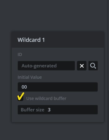

It won't work because you didn't checked the checkbox "use wildcard buffer" on your text Area. Like this :
It's not explicitly said in the tutorial 4. Thanks for reporting this. We will do the modification for the next version of the documentation because it might be confusing indeed.

Thank you very much!
It also helped me with another problem that I had. I just missed to select "Use wildcard buffer". Now it works, thank you.
