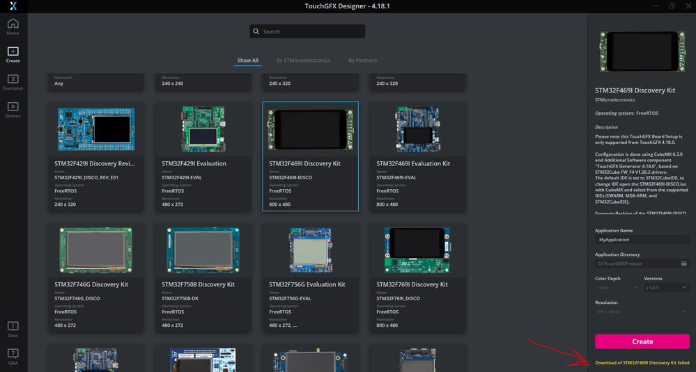

Hi
I'm having the same problem.
Tried your solutions but I was not successful.
Thanks,
Mas
Close TouchGFX Designer before opening a browser like Microsoft Edge and reopen it. This error message can also appear when your internet connection struggles downloading the packages due to its size/your internet connection speed. So you might need to try a few times unfortunately or download directly the TBS through this link for the STM32F469I Discovery kit:
https://sw-center-st-com.s3.eu-west-1.amazonaws.com/touchgfx/pacman/4.18.0/STM32F469I-DISCO/STM32F469I-DISCO-3.0.5.zip
/Romain
Mas1
@Romain DIELEMAN​
Thanks so much
it is fixed
