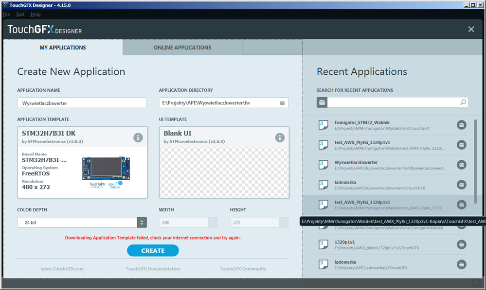

I'm trying to create new project with STM32H7B3I-DK and the following error is reporter. Designer version 4.15.0

‎2020-11-26 9:24 PM
Please load a page on your favorite browser before trying to create your project and tell me if you still have the issue.
/Alexandre

Supprisingly it worked today just fine. I've tried yesterday and the result was not OK, but today it works. I'm sure it was not my internet connection, because I could see TouchGFX downloading some data and after that error message appeared.
Anyway, thank for helping with the issue, I can go back to my project now.
‎2020-11-29 5:21 PM
Glad it is fine for you now :grinning_face:
It's not your internet connection that was the problem but simply the connection to the server where you have the Application Templates. Sorry about that.
If it happens again, doing what mentioned in my previous answer should fix the issue in most cases.

‎2021-01-26 12:39 AM
I'm facing the same problem with the same board template only, despite having a page open on the browser and having a functionnal internet connection. The downloading fail at 21-22%. Here's the log file :

‎2021-01-26 2:21 AM
Here is a link to download the application template for the H7B3 dk board: the http://sw-center.st.com/touchgfx/pacman/4.16.0/STM32H7B3I-DK/STM32H7B3I-DK-3.0.4.zip
The issue could come from your firewall, are you downloading it on your private or office computer ?
/Romain

‎2021-01-26 2:40 AM
Thanks for your answer.
I tried on TouchGFX 4.16 version and it didn't work. Indeed I'm in a office network, so I tried to download the template with my personnal network and it worked. And now the downloading seems to work also with the office network.
