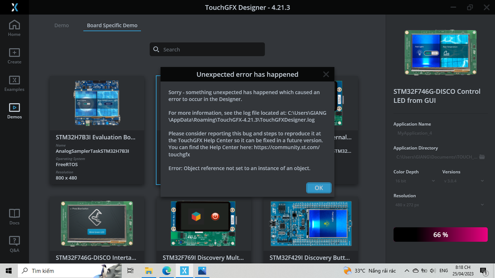

Touchgfx Designer is not opening in the computer.
MPath.4
 last time also this problem was occured so I installed it again after that it run for some days now again the problem has occured.
 When I open Touchgfx one msg come
Sorry - something unexpected has happened which caused an error to occur in the Designer.
For more information, see the log file located at: C:\Users\Kaushal\AppData\Roaming\TouchGFX-4.21.3\TouchGFXDesigner.log
Please someone help to give the solution of it.

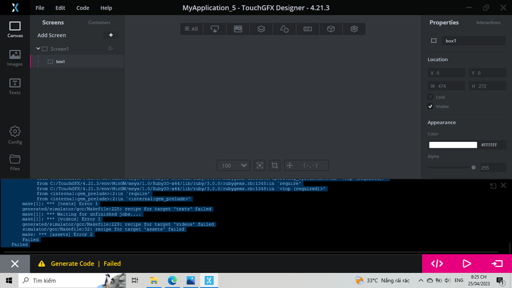

​i have same problem with u
​when i using demo
when i trying Generate Code, run simulator and run target has same this error
Generate Code
  Copy Framework
    Copying TouchGFX framework version 4.21.3 to C:\Users\GIANG\Documents\TOUCH_GFX\MyApplication_5\Middlewares\ST\touchgfx

  Generate Assets
    make -f simulator/gcc/Makefile assets -j8
    Reading ./application.config
    Reading ./target.config
    Generating generated/images/include/BitmapDatabase.hpp
    Generating generated/images/include/images/BitmapDatabase.hpp
    Generating generated/images/src/BitmapDatabase.cpp
    Generating generated/images/include/images/SVGDatabase.hpp
    Generating generated/images/src/SVGDatabase.cpp
    C:/TouchGFX/4.21.3/env/MinGW/msys/1.0/Ruby30-x64/lib/ruby/3.0.0/win32/registry.rb:910:in `encode': code converter not found (UTF-16LE to Windows-1258) (Encoding::ConverterNotFoundError)

    make[1]: *** [texts] Error 1
    generated/simulator/gcc/Makefile:225: recipe for target 'texts' failed
    make[1]: *** Waiting for unfinished jobs....
    make[1]: *** [videos] Error 1
    generated/simulator/gcc/Makefile:229: recipe for target 'videos' failed
    simulator/gcc/Makefile:32: recipe for target 'assets' failed
    make: *** [assets] Error 2
    Failed
  Failed
Weird, that does not happen for me with 4.21.3.
Could you please try with the new 4.21.4 we just released, and let me know how it is going ?

your file is full of zeros and not a valid .touchgfx file
