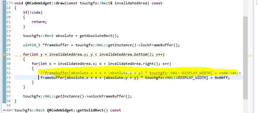

Hello, I found answers of few question. Please help me with below few questions:
1) Whats is the correct way of passing value of QR pixel ? Should I pass similar to below highlighted code from some QR pixel array generated by some library.

I don't know why calling code->at(x... would be slow. it's just looking up a value for some position of the QR code.
/Martn

1) Whats is the correct way of passing value of QR pixel ? Should I pass similar to above highlighted code from some QR pixel array generated by some library.
There's no correct way. The QR code is just some C++ code. I'm not sure how this all fits into your application. The QR code we supply is just a sample - it auto-generates the entries. If you have some tool to generate for you, you have to figure out how you can "port" the format to our QR code example, or come up with your own way. It's up to you.
