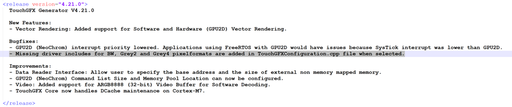

TouchGFX\target\generated\TouchGFXConfiguration.cpp(32): error: #20: identifier "LCD1bpp" is undefined
It looks like the Middlewares\ST\touchgfx\framework\include\platform\driver\lcd\LCD1bpp.h is not included.
Had anyone this problem before?

Indeed, this bug was fixed in 4.21.0, you can see it if you open the .pdsc inside the X-CUBE-TouchGFX installation repository :

any update on this? it is a error of the code generation. after every generation i manually have to add this header

i think this bug is fixed now...if i regenrate the code this header gets added.
i think there were some bigger changes in code generation because in the past you had these markers for private code and code managed by touchgfx/cubeMX which are not there anymore
