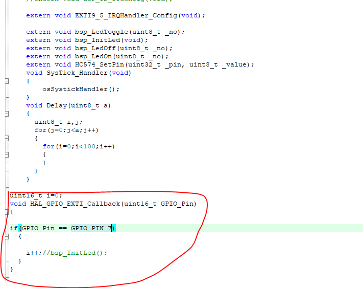

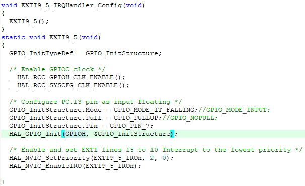

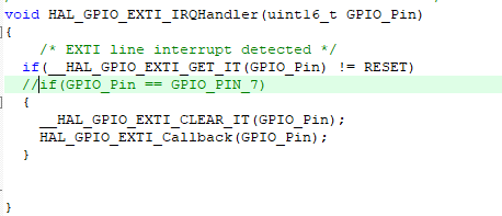

I am using STM32H743 with my development board,and I am trying to build a Interrupt for the touch function,codes are down below.
By the way, the code is generated by TouchGFX and Board STM32H743I_EVAL.
Pin defined
Interrupt function in C++ file
This is the detecting pin function
Last is my test interrupt is break in or not.
I tried a lot but it didn`t work.
Is there any one can help?
Thank you!

Yes,I am trying to build it with interrupt function,but I face the problem is that in Debug Mode didn`t detect where I touch then run into my Interrupt function.
Is it make the wrong way about build the function?

The interrupt function should be set the breakpoint in Debug Mode then run the code ,and it can go in to interrupt Subprogram.
If I do not set breakpointm, it will not go in there.
